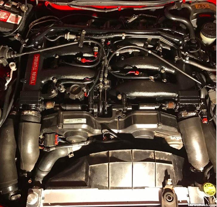

Message delete those coolant hoses.
Repace the random vacuum hose with z1 things.
Paint valve covers and plenum with engine paint ftw.
replace crush washers on valve covers. z1 or concept z sells them at decent prices.
I did injectors and also replaced fuel rail insulators at this time.
Don't over torque stuff.
